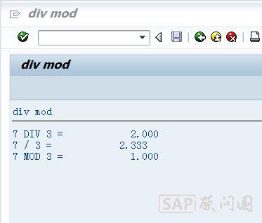

测试程序:
  1. DATA:menge TYPE mseg-menge. "Type i
  2. menge = 7 DIV 3.
  3. WRITE:'7 DIV 3 =',menge.
  4. menge = 7 / 3.
  5. WRITE:/ '7 / 3 =',menge.
  6. menge = 7 MOD 3.
  7. WRITE:/ '7 MOD 3 =',menge.
执行结果:
