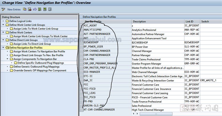

Transaction Code: CRMC_UI_NBLINKS
Path in SPRO -> Customer Relationship Management->UI Framework->Technical Role Definition->Define Navigation Bar Profile
Execute the Transaction directly or go to the SPRO transaction in the above mentioned path and click on Execute button.
All highlighted options are navigation bar profiles. You can scroll down and up to see more profiles. We need to know a little about the options which are in left panel. Double click on first option logical links and you will see all logical links in the right panel as highlighted in the below mentioned screen shot.
