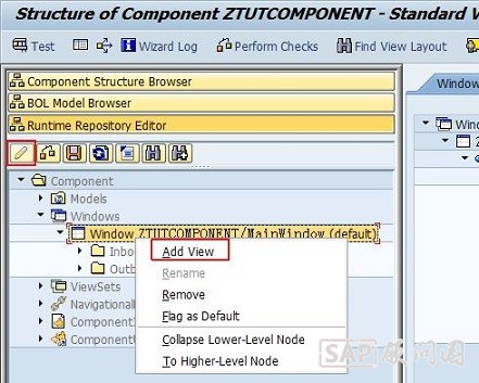

Because, we did not assign our view to any window. As discussed, we need to put the view inside a window to make it visible on the web ui. We will do it in the runtime repository.
Open the component and click on RUNTIME REPOSITORY and choose EDIT button. right click on the window and choose the option add view as shown below.
In the next popup, choose the view that exists in our application and continue.
Save the runtime repository by pressing on save button. Now our view is assigned to the MAIN WINDOW of our component.
