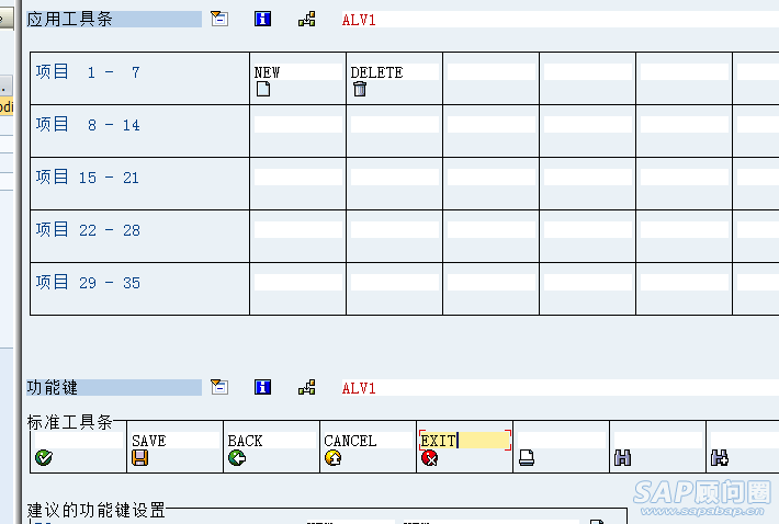

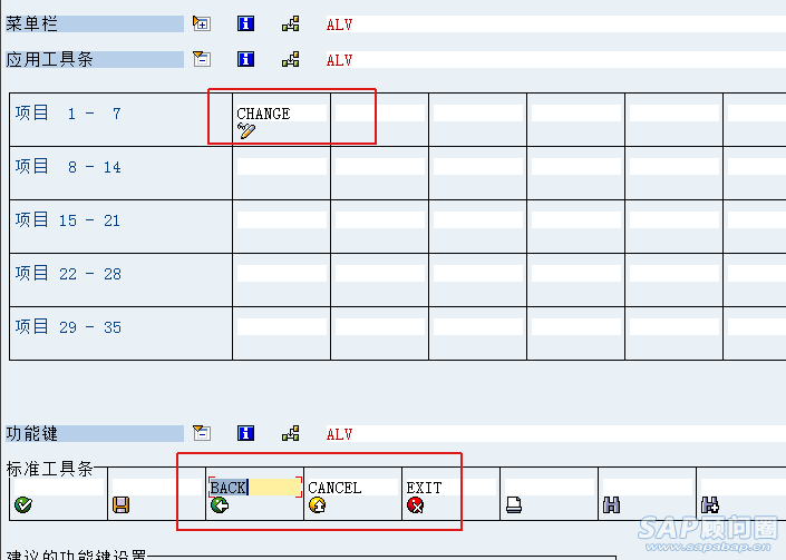

[动态alv] 使用ooalv方式动态的创建、修改和删除自定义表记录

  42. AT SELECTION-SCREEN.
  43.   CASE sy-ucomm.
  44.     WHEN 'B1'.
  45.       SET PF-STATUS  'ALV'.
  46.       CALL SCREEN 9001.
  47.     WHEN 'B2'.
  48.       SET PF-STATUS 'ALV1'.
  49.       CALL SCREEN 9001.
  50.   ENDCASE.

  174. *    li_fieldcat   TYPE lvc_t_fcat,
  175. *    lwa_fieldcat  TYPE lvc_s_fcat.
  176.   CASE sy-ucomm.
  177.     WHEN 'CHANGE'.
  178.       SET PF-STATUS 'ALV1'.

PS:
1、container名称:CUSTOM_CONTAINER
2、创建PF Status —— “ALV”   “ALV1”
3、创建Text Elements
4、创建T-code – SE93
