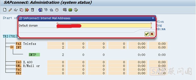

1. Enter the Value for Default Domain
Under Settings -> Default Domain, define the domain of the SAP system client. This allows for the following to take place:
1.1* The SMTP plug-in logs on to the mail server using the domain as ID
1.2* The message ID of the outbound e-mails is assembled with this domain.
1.3* If an SAP user who does not have an Internet mail address sends an e-mail, a sender address consisting of the SAP user name and this domain is generated.

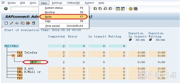

Choose the Menu Option
Views -> Nodes -> in the subsequent screen, expand INT -> double click on SMTP

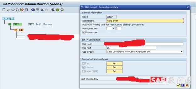

Step No 2 In the Subsequent Screen… enter the following informations.
How often the Mail should be sent. (mostly every 5 minutes)
Check the “checkbox” “Node in use”
Enter the “SMTP Mail Server Host Name”
Enter the SMTP Port Number (usually 25).
Click on the button “Set”.
mail host:
sicf->直接点执行->选中SAPconnect->service菜单->activate就可以了
或者填写所要发送到的邮件服务器地址

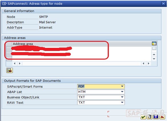

Step No 3 In the Subsequent Screen… enter the following informations.
Address Areas :- To which all address (domains) the mails can be sent.
“*” means emails can go to any E-Mail Addreses, while *yahoo.com means the mails can go to only to users in the yahoo.com domain

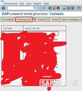

Step 6 In the subsequent screen, Click once on the “SAP&CONNECTALL” and double click on the button “Schedule Job”.

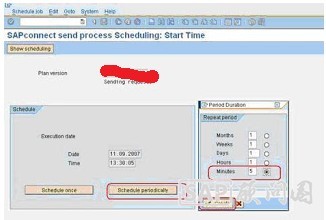

Step 7 In the subsequent screen
Click on the Button “Schedule Periodically” and select how often the Background job should run (mostly every 5 minutes)
Click on create button
A new node will appear in the Jobs screen.
In Tx Code SM37, check whether the New Job, is scheduled or not.

a)菜单栏 设置----Default domain,此处我写的是公司的邮件服务器
这个邮件的默认域名比如sap.com,那么如果在你发送邮件的时候收件人地址如果只写test的话,系统会自动加上@sap.com,如果收件人地址是全的话,这个domain不维护关系也不大
b) 维护SMTP节点:视图----节点Nodes—打开节点
或者双击上上图SMTP后弹出对话框,维护以下信息
勾上 "Node in user".
在MAIL HOST和MAIL PORT下面,指定发送邮件服务器的地址,比如如果是163的话,就应该是smtp.163.com
这里MAIL HOST填写我公司邮件服务器地址,MAIL PORT填写25
选中Internet的Set,弹出新对话框,指定接收地址的地址区域,一般用*表示所有邮件都用SMTP来发送。其他信息用默认。

c)Send job,选择菜单中的视图View-->职务Jobs,可以检查是否已经有Jobs被调度了
选择Jobs->Create,并指定Job名称,点执行按钮
选择SAP&CONNECTALL变式,并选择Schedule Job
选择 Schedule periodiacally定期计划,指定时间间隔,比如10分钟,选择创建。
到这里,基本配置成功了。
