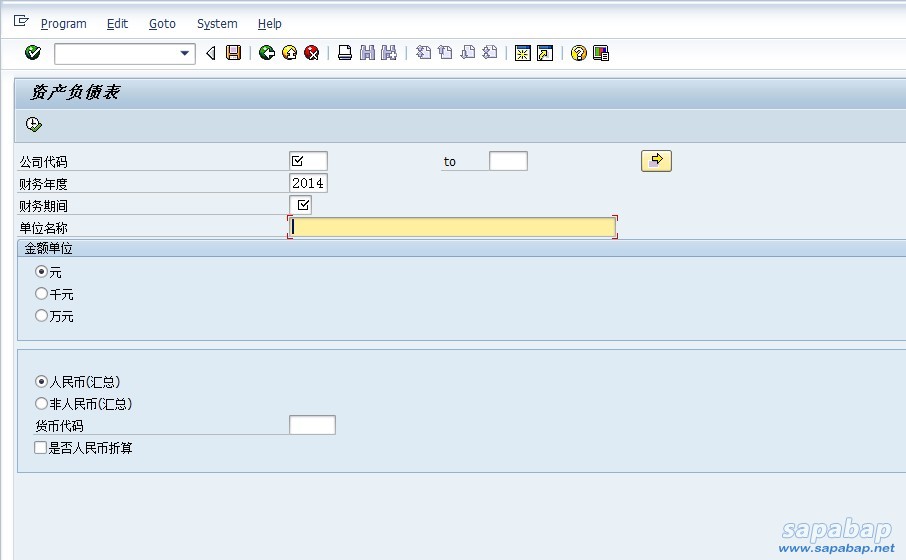

选择屏幕:

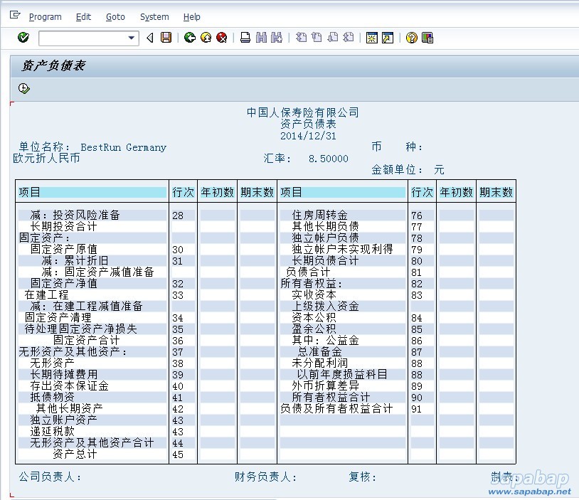

程序执行结果屏幕:

  75. *& selection-screen
  76. *&---------------------------------------------------------------------*
  77. SELECT-OPTIONS:
  78.   s_rbukrs FOR bkpf-bukrs OBLIGATORY .     "公司代码
  79. PARAMETERS:
  80.   i_gjahr LIKE bkpf-gjahr DEFAULT sy-datum+0(4) OBLIGATORY,  "财务年度
  81.   i_monat LIKE bkpf-monat OBLIGATORY,      "期间
  82. *  waers   like bkpf-waers OBLIGATORY.      "货币代码
  83.   p_butxt(40) TYPE c.
  84. SELECTION-SCREEN BEGIN OF BLOCK b02 WITH FRAME TITLE tit.  "选择屏幕
  85. PARAMETERS:                                                 "单选按钮
  86.    p_1  RADIOBUTTON GROUP g1 DEFAULT 'X',
  87.    p_2  RADIOBUTTON GROUP g1,
  88.    p_3  RADIOBUTTON GROUP g1.
  89. SELECTION-SCREEN END OF BLOCK b02.                          "选择屏幕结束
  90. SELECTION-SCREEN BEGIN OF BLOCK b01 WITH FRAME TITLE text-001.
  91. PARAMETERS:                                                 "单选按钮
  92.    m_1  RADIOBUTTON GROUP g2 DEFAULT 'X',
  93.    m_2  RADIOBUTTON GROUP g2,
  94.    waers   LIKE bkpf-waers ,      "货币代码
  95.    p_flag AS CHECKBOX.
  96. SELECTION-SCREEN END OF BLOCK b01.
