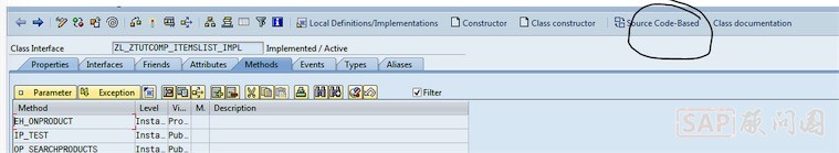

We are not over. We need to change the visibility of this method in the subclass as well. Go back to the view implementation class. Change into edit mode and click on button SOURCE code based as shown below.
It will list the class code.

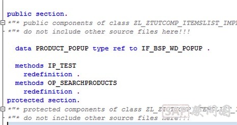

Move the code ‘methods OP_SEARCHPRODUCTS redefinition’ from protected section to the public section as below.  Now Let us code in the method. Write the following code inside the method.
Now activate the class. While activating choose all entries in the list. Now you can see the visibility of this method as public in the view implementation class.
Here PRODUCT_POPUP is a public attribute of view implementation class.

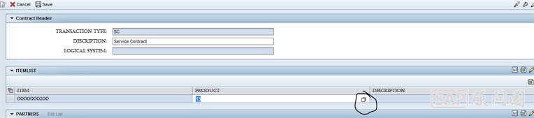

At this step, pop up is ready. As soon as user presses the F4 button on the field, first outbound plug will be triggered and the above code will be executed and pop up will be created.
On the pop up, user will be presented two screens to search the product and to see the results. Then user will choose any product. Once he chooses, control automatically goes the event handler that we set using the method SET ON CLOSE EVENT. So we need to get the product that user selected on the pop up , in this event handler.

Test the application.
