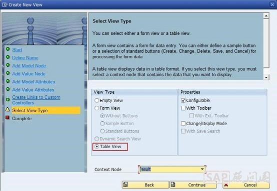

Go to the UI component and create one more view. Give the view name and in the second step, give node name as result and choose the BTQRSrvCon.
Just keep pressing continue until select view type step.  Here choose the view type as TABLE and context node as result. Check the configurable check box.
Complete the wizard and save all entries. (Try to observe how many classes wizard will generate while saving. You can see impl class, ctxt class, cn00 class. )
