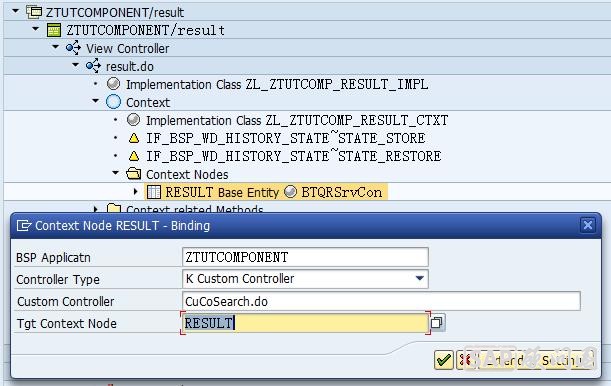

Next we will bind the two context nodes. Go to the result view and  Right click on the result context node  and choose the option create binding.
In the next pop up , choose the controller type as custom controller as we are binding the data to result view.
Choose CuCoSearch.do as view controller in the custom controller field and choose the result context node and press on right mark.  That’s it, we have done the binding.
once above step is done, We can observer the binding here.
It is saying the result context node of custom controller is bound to the result context node view RESULT.
