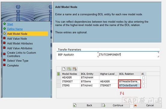

Then we need to specify the relation between the base entity of higher level context node to the base entity of dependent context node.  Click on BOL relation and choose the value.
We need to add one more model node, which will be dependent on ITEMSET node. Click on create and in the new row give context node name and choose BTAdminI as base entity. To make it dependent on ITEMSET context node chooses entries as shown below.
Here BTAdminI is dependent on BTItems and BTItems dependent on BTAdminH.  So if we are able to feed the data to BTAdminH. With help of relations, required data automatically flows to its child nodes. Just click on continue up to the step CREATE LINKS TO CUSTOM CONTROLLERS.
