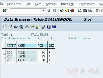

I have created below table in se11 and records in it. I am going to create one table view which is based on this table.
Data of that table.
