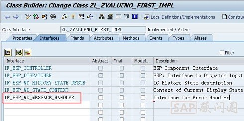

We need to add one interface ‘IF_BSP_WD_MESSAGE_HANDLER’ to our view implementation class as a first step if it is not available already.
After adding, activate the class.
