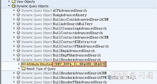

Which dynamic query object is used to implement the BP SEARCH?
Ans : Dynamic Query Object ‘BuilHeaderAdvancedSearch’.
What is the base structure of this query object?
Ans:  Attribute Structure CRMT_BUPA_IL_HEADER_SEARCH.

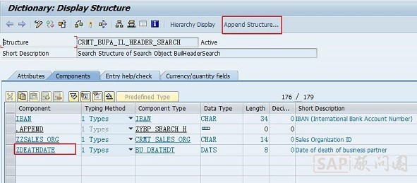

So we need to append our new field to this structure in se11 transaction.  Go to the transaction SE11 and append new field to the above structure.

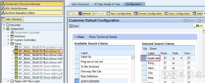

Save and activate the structure. This makes the newly added field available in the UI configuration in the component BP_HEAD_SEARCH.
Go to this component and view MAINSEARCH configuration and move the new field from available search criteria to the selected search criteria.
Now we can go to the search page on the WEB UI and we can see the newly added field over there.

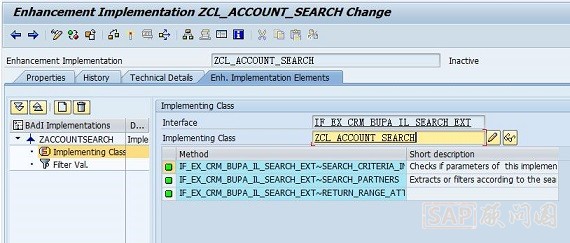

Next we need to create one new implementation for the BADI ‘BADI_CRM_BUPA_IL_SEARCH_EXT’ under enhancement spot ‘CRM_BUPA_IL_SEARCH’.
Go to the transaction se18 and give the above enhancement spot name in the enhancement spot field and click on display.
Next right click on the BADI ‘BADI_CRM_BUPA_IL_SEARCH_EXT’ and choose the option CREATE BADI implementation.
It will show already existing enhancement implementations in the next Dialog box. Choose create option.
Give suitable name and description and leave the last field as blank.
Once you choose continue, there will be one more dialog box. Here we need give suitable name , description and class name to create BADI implementation. Once you choose continue, then following new implementation will be displayed as below.
Choose Default implementation check box and Implementation is activate.
Expand the new implementation and double click on implementing class. It will list class methods along with the details.
