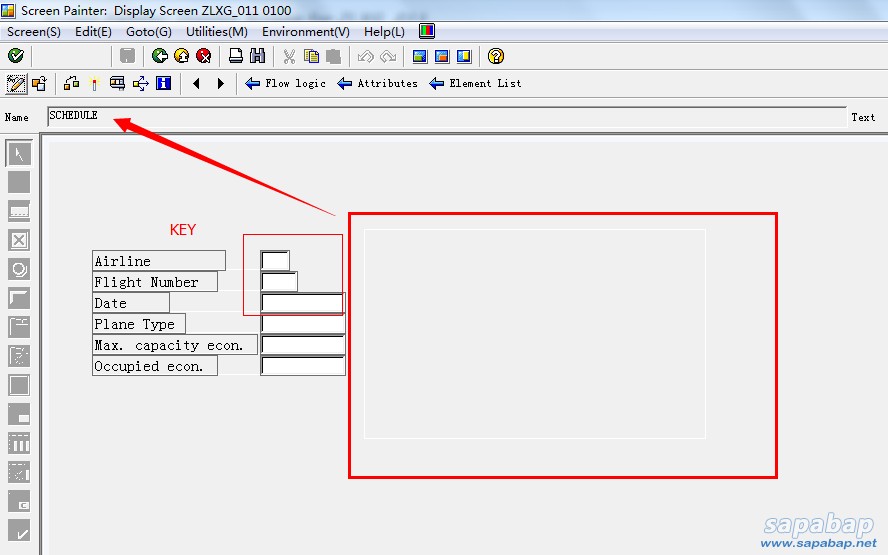

注意:
一.screen 100
1.attributes->normal screen
2.element list->定义ok_code
3.flow logic
  1. PROCESS BEFORE OUTPUT.
  2. MODULE STATUS_0100.
  3. CALL SUBSCREEN SCHEDULE
  4. INCLUDING SY-repid '0110'.  "SY-repid = SY-cprog
  5. *
  6. PROCESS AFTER INPUT.
  7. MODULE USER_COMMAND_0100 AT EXIT-COMMAND.
  8. CALL SUBSCREEN SCHEDULE.
  9. CHAIN.
  10. FIELD: SFLIGHT-CARRID,SFLIGHT-CONNID,SFLIGHT-FLDATE.
  11. MODULE CHECK_FLDATE ON CHAIN-REQUEST.
  12. ENDCHAIN.
4.screen painter
5.画painter时 可以用数据字典的结构 拖拽添加 (把主键都选上,别的字段随便加几个)
