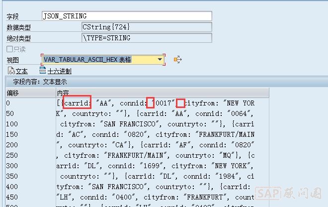

1、cl_trex_json_serializer、cl_trex_json_deserializer方式
  1. DATA: lo_json_ser TYPE REF TO cl_trex_json_serializer,
  2.       lo_json_des TYPE REF TO cl_trex_json_deserializer.
  3. DATA: json_string TYPE string.
  4. DATA:BEGIN OF lt_spfli OCCURS 0,
  5.         carrid    TYPE spfli-carrid,
  6.         connid    TYPE spfli-connid,
  7.         cityfrom  TYPE spfli-cityfrom,
  8.         countryto TYPE spfli-countryto,
  9.      END OF lt_spfli.
  10. START-OF-SELECTION.
  11.   SELECT
  12.     carrid
  13.     connid
  14.     cityfrom
  15.     countryto
  16.   UP TO 10 ROWS
  17.   INTO TABLE lt_spfli
  18.   FROM spfli.
  19. *内表->JSON
  20.   CREATE OBJECT lo_json_ser
  21.     EXPORTING
  22.       data = lt_spfli[].
  23.   CALL METHOD lo_json_ser->serialize.
  24.   CALL METHOD lo_json_ser->get_data
  25.     RECEIVING
  26.       rval = json_string.
  27.   WRITE:json_string.
  28.   CLEAR:lt_spfli[].
  29. *JSON->内表
  30.   CREATE OBJECT lo_json_des.
  31.   CALL METHOD lo_json_des->deserialize
  32.     EXPORTING
  33.       json = json_string
  34.     IMPORTING
  35.       abap = lt_spfli[].
该种转换方式,生成的JSON,KEY关键字没有引号,字符串中包含空格,如果与第三方系统做接口时,就会因为JSON格式问题,导致接口失败。

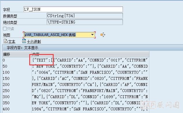

2、CALL TRANSFORMATION id 方式
  1. DATA:BEGIN OF lt_spfli OCCURS 0,
  2.         carrid    TYPE spfli-carrid,
  3.         connid    TYPE spfli-connid,
  4.         cityfrom  TYPE spfli-cityfrom,
  5.         countryto TYPE spfli-countryto,
  6.      END OF lt_spfli.
  7. DATA: lo_writer          TYPE REF TO cl_sxml_string_writer,
  8.       lv_output_length   TYPE i,
  9.       lt_binary_tab      TYPE STANDARD TABLE OF sdokcntbin,
  10.       lv_jsonx           TYPE xstring,
  11.       lv_json            TYPE string.
  12. SELECT  carrid
  13.         connid
  14.         cityfrom
  15.         countryto
  16. UP TO 10 ROWS
  18. FROM spfli.
  19. * ABAP to JSON
  20. lo_writer = cl_sxml_string_writer=>create( type = if_sxml=>co_xt_json ).
  21. CALL TRANSFORMATION id SOURCE text = lt_spfli[] RESULT XML lo_writer.
  22. lv_jsonx = lo_writer->get_output( ).
  23. CALL FUNCTION 'SCMS_XSTRING_TO_BINARY'
  24.   EXPORTING
  25.     buffer        = lv_jsonx
  26.   IMPORTING
  27.     output_length = lv_output_length
  28.   TABLES
  29.     binary_tab    = lt_binary_tab.
  30. CALL FUNCTION 'SCMS_BINARY_TO_STRING'
  31.   EXPORTING
  32.     input_length  = lv_output_length
  33.   IMPORTING
  34.     text_buffer   = lv_json
  35.     output_length = lv_output_length
  36.   TABLES
  37.     binary_tab    = lt_binary_tab.
  38. * JSON to ABAP
  39. CALL TRANSFORMATION id SOURCE XML lv_jsonx RESULT text = lt_spfli.
该种JSON转换生成的数据,比内表数据多了一部分“TEXT”字符串,也不是很满意
