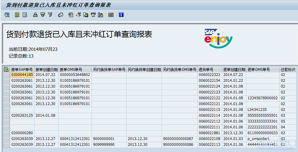

货到付款退货已入库且未冲红订单查询报表
Twilight发表于 2014-07-23 16:16Twilight 最后回复于 2014-07-23 16:16 [复制链接] 4375 0
NOTE:当数据库表数据达到数亿级别时,不走索引或主键,几乎跑不出来,会超时报错。当不能建索引时,我们可以将日期拆分成单天的方式去关联vbak,这样select就会很快了,在loop这个select就能查出全部数据了。

  212. FORM f_displsy_data .
  213.   DATA: lt_fieldcat_lvc TYPE lvc_t_fcat.
  214.   DATA: ls_layout_lvc TYPE lvc_s_layo.
  215.   ls_layout_lvc-cwidth_opt = 'X'.
  216.   ls_layout_lvc-box_fname = 'BOX'.
  217.   PERFORM f_fieldcate_lvc TABLES lt_fieldcat_lvc  USING '1' 'VBELN_BE' '原单SAP单号'.
  218.   PERFORM f_fieldcate_lvc TABLES lt_fieldcat_lvc  USING '2' 'ERDAT_BE' '原单创建日期'.
  219.   PERFORM f_fieldcate_lvc TABLES lt_fieldcat_lvc  USING '3' 'P_OMSORDER_BE' '原单OMS单号'.
  220.   PERFORM f_fieldcate_lvc TABLES lt_fieldcat_lvc  USING '4' 'VBELN_NY' '另约换货单SAP单号'.
  221.   PERFORM f_fieldcate_lvc TABLES lt_fieldcat_lvc  USING '5' 'ERDAT_NY' '另约换货单创建日期'.
  222.   PERFORM f_fieldcate_lvc TABLES lt_fieldcat_lvc  USING '6' 'P_OMSORDER_NY' '另约换货单OMS单号'.
  223.   PERFORM f_fieldcate_lvc TABLES lt_fieldcat_lvc  USING '7' 'VBELN_NE' '退货单号'.
  224.   PERFORM f_fieldcate_lvc TABLES lt_fieldcat_lvc  USING '8' 'ERDAT_NE' '退单创建日期'.
  225.   PERFORM f_fieldcate_lvc TABLES lt_fieldcat_lvc  USING '9' 'P_OMSORDER_NE' '退单OMS单号'.
  226.   PERFORM f_fieldcate_lvc TABLES lt_fieldcat_lvc  USING '10' 'ZHKFS' '还款标识'.
  227.   CALL FUNCTION 'REUSE_ALV_GRID_DISPLAY_LVC'
  228.     EXPORTING
  229. *   I_INTERFACE_CHECK                 = ' '
  230. *   I_BYPASSING_BUFFER                =
  231. *   I_BUFFER_ACTIVE                   =
  232.     i_callback_program                = sy-repid
  233. *   I_CALLBACK_PF_STATUS_SET          = ' '
  234. *   I_CALLBACK_USER_COMMAND           = ' '
  235.     i_callback_top_of_page            = 'TOP_OF_PAGE'
  236. *   I_CALLBACK_HTML_TOP_OF_PAGE       = ' '
  237. *   I_CALLBACK_HTML_END_OF_LIST       = ' '
  238. *   I_STRUCTURE_NAME                  =
  239. *   I_BACKGROUND_ID                   = ' '
  240. *   I_GRID_TITLE                      =
  241. *   I_GRID_SETTINGS                   =
  242.     is_layout_lvc                     = ls_layout_lvc
  243.     it_fieldcat_lvc                   = lt_fieldcat_lvc
  244. * IMPORTING
  245. *   E_EXIT_CAUSED_BY_CALLER           =
  246. *   ES_EXIT_CAUSED_BY_USER            =
  247.     TABLES
  248.       t_outtab                          = gt_vbak[]
  249. * EXCEPTIONS
  250. *   PROGRAM_ERROR                     = 1
  251. *   OTHERS                            = 2
  252.             .
  253. ENDFORM.                    " f_displsy_data
  254. *&---------------------------------------------------------------------*
  255. *&      Form  f_fieldcate_lvc
  256. *&---------------------------------------------------------------------*
  257. *       alv的fieldcate子过程
  258. *----------------------------------------------------------------------*
  259. FORM f_fieldcate_lvc TABLES pt_fieldcat_lvc TYPE lvc_t_fcat
  260.                      USING p_col_pos TYPE i
  261.                            p_fieldname TYPE c
  262.                            p_scrtext_m TYPE c.
  263.   DATA: ps_fieldcat_lvc TYPE lvc_s_fcat.
  264.   CLEAR ps_fieldcat_lvc.
  265.   ps_fieldcat_lvc-col_pos     = p_col_pos.
  266.   ps_fieldcat_lvc-fieldname   = p_fieldname.
  267.   ps_fieldcat_lvc-scrtext_l   = p_scrtext_m.
  268.   APPEND ps_fieldcat_lvc TO pt_fieldcat_lvc.
  269. ENDFORM.                    " f_fieldcate_lvc
  270. *&---------------------------------------------------------------------*
  271. *&      Form  TOP_OF_LIST
  272. *&---------------------------------------------------------------------*
  273. *       text
  274. *----------------------------------------------------------------------*
  275. FORM top_of_page.
  276.   DATA:lt_list_comments TYPE slis_t_listheader,  "alv表单标题区域设置
  277.        ls_list_comments LIKE LINE OF lt_list_comments.
  278.   DATA: lv_tabline    TYPE i.  "存储内表行数
  279.   CLEAR: lt_list_comments.
  280.   ls_list_comments-typ = 'H'.
  281.   ls_list_comments-key = ''.
  282.   ls_list_comments-info = '货到付款退货已入库且未冲红订单查询报表'.
  283.   APPEND ls_list_comments TO lt_list_comments.
  284.   CLEAR ls_list_comments.
  285.   DATA: lv_data_temp(22).
  286.   WRITE sy-datum TO: lv_data_temp USING EDIT MASK '____年__月__日'.
  287.   CONCATENATE '当前日期: ' lv_data_temp INTO lv_data_temp.
  288.   ls_list_comments-typ = 'S'.
  289.   ls_list_comments-key = ''.
  290.   ls_list_comments-info = lv_data_temp.
  291.   APPEND ls_list_comments TO lt_list_comments.
  292.   CLEAR ls_list_comments.
  293.   DESCRIBE TABLE gt_vbak LINES lv_tabline.
  294.   DATA:lv_sum_line(20) TYPE c .
  295.   lv_sum_line = lv_tabline.
  296.   CONDENSE lv_sum_line NO-GAPS.
  297.   CONCATENATE '记录总数: ' lv_sum_line INTO lv_sum_line.
  298.   ls_list_comments-typ = 'S'.
  299.   ls_list_comments-key = ''.
  300.   ls_list_comments-info = lv_sum_line.
  301.   APPEND ls_list_comments TO lt_list_comments.
  302.   CLEAR ls_list_comments.
  303.   CALL FUNCTION 'REUSE_ALV_COMMENTARY_WRITE'   "T-CODE : OAER    PARAMENTS: PICTURES OT
