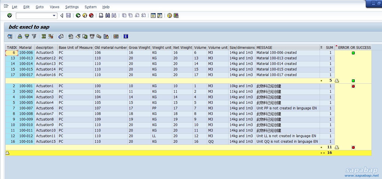

测试数据执行效果图
主要功能
1.文件路径的有效性检查
2.成功和错误消息 红绿灯分类汇总
3.通过tabix标记出ALV中每行数据在execl中的位置
4.execl中数据在bdc之前的check检查
4.alv显示整个效果

  269. ENDFORM.                    " BDC_TRANSACTION
  270. *&---------------------------------------------------------------------*
  271. *&      Form  DIAPLAY_MESSAGE
  272. *&---------------------------------------------------------------------*
  273. *       text
  274. *----------------------------------------------------------------------*
  275. *  -->  p1        text
  276. *  <--  p2        text
  277. *----------------------------------------------------------------------*
  278. FORM DIAPLAY_MESSAGE .
  279. *分类汇总 需要do_sum配合
  280.   DATA IT_SORT_LVC TYPE LVC_T_SORT.
  281.   DATA WA_SORT_LVC TYPE LVC_S_SORT.
  282.   CLEAR WA_SORT_LVC.
  283.   WA_SORT_LVC-SPOS = 1.
  284.   WA_SORT_LVC-FIELDNAME = 'ICON'.
  285.   WA_SORT_LVC-UP = 'X'.
  286.   WA_SORT_LVC-SUBTOT = 'X'.
  287.   APPEND WA_SORT_LVC TO IT_SORT_LVC.
  288.   DATA IS_LAYOUT_LVC TYPE LVC_S_LAYO.
  289.   CLEAR IS_LAYOUT_LVC.
  290.   IS_LAYOUT_LVC-ZEBRA = 'X'.
  291.   IS_LAYOUT_LVC-CWIDTH_OPT = 'X'.
  292.   DATA IT_FIELDCAT_LVC TYPE LVC_T_FCAT.
  293.   DATA WA_FIELDCAT_LVC TYPE LINE OF LVC_T_FCAT.
  294.   CLEAR WA_FIELDCAT_LVC.
  295.   WA_FIELDCAT_LVC-COL_POS = 1.
  296.   WA_FIELDCAT_LVC-KEY = 'X'.
  297.   WA_FIELDCAT_LVC-FIELDNAME = 'TABIX'.
  298.   WA_FIELDCAT_LVC-REPTEXT = 'TABIX'.
  299.   APPEND WA_FIELDCAT_LVC TO IT_FIELDCAT_LVC.
  300.   CLEAR WA_FIELDCAT_LVC.
  301.   WA_FIELDCAT_LVC-COL_POS = 2.
  302.   WA_FIELDCAT_LVC-KEY = 'X'.
  303.   WA_FIELDCAT_LVC-FIELDNAME = 'MAT_NO'.
  304.   WA_FIELDCAT_LVC-REPTEXT = 'Material'.
  305.   APPEND WA_FIELDCAT_LVC TO IT_FIELDCAT_LVC.
  306.   CLEAR WA_FIELDCAT_LVC.
  307.   WA_FIELDCAT_LVC-COL_POS = 3.
  308.   WA_FIELDCAT_LVC-FIELDNAME = 'MAT_NAME'.
  309.   WA_FIELDCAT_LVC-REPTEXT = 'description'.
  310.   APPEND WA_FIELDCAT_LVC TO IT_FIELDCAT_LVC.
  311.   CLEAR WA_FIELDCAT_LVC.
  312.   WA_FIELDCAT_LVC-COL_POS = 4.
  313.   WA_FIELDCAT_LVC-FIELDNAME = 'MEINS'.
  314.   WA_FIELDCAT_LVC-REPTEXT = 'Base Unit of Measure'.
  315.   APPEND WA_FIELDCAT_LVC TO IT_FIELDCAT_LVC.
  316.   CLEAR WA_FIELDCAT_LVC.
  317.   WA_FIELDCAT_LVC-COL_POS = 5.
  318.   WA_FIELDCAT_LVC-FIELDNAME = 'OLD_MAT_NAME'.
  319.   WA_FIELDCAT_LVC-REPTEXT = 'Old material number'.
  320.   APPEND WA_FIELDCAT_LVC TO IT_FIELDCAT_LVC.
  321.   CLEAR WA_FIELDCAT_LVC.
  322.   WA_FIELDCAT_LVC-COL_POS = 6.
  323.   WA_FIELDCAT_LVC-FIELDNAME = 'GROSS_WT'.
  324.   WA_FIELDCAT_LVC-REPTEXT = 'Gross Weight'.
  325.   APPEND WA_FIELDCAT_LVC TO IT_FIELDCAT_LVC.
  326.   CLEAR WA_FIELDCAT_LVC.
  327.   WA_FIELDCAT_LVC-COL_POS = 7.
  328.   WA_FIELDCAT_LVC-FIELDNAME = 'WT_UNIT'.
  329.   WA_FIELDCAT_LVC-REPTEXT = 'Weight unit'.
  330.   APPEND WA_FIELDCAT_LVC TO IT_FIELDCAT_LVC.
  331.   CLEAR WA_FIELDCAT_LVC.
  332.   WA_FIELDCAT_LVC-COL_POS = 8.
  333.   WA_FIELDCAT_LVC-FIELDNAME = 'NTGEW'.
  334.   WA_FIELDCAT_LVC-REPTEXT = 'Net Weight'.
  335.   APPEND WA_FIELDCAT_LVC TO IT_FIELDCAT_LVC.
  336.   CLEAR WA_FIELDCAT_LVC.
  337.   WA_FIELDCAT_LVC-COL_POS = 9.
  338.   WA_FIELDCAT_LVC-FIELDNAME = 'VOLUM'.
  339.   WA_FIELDCAT_LVC-REPTEXT = 'Volume'.
  340.   APPEND WA_FIELDCAT_LVC TO IT_FIELDCAT_LVC.
  341.   CLEAR WA_FIELDCAT_LVC.
  342.   WA_FIELDCAT_LVC-COL_POS = 10.
  343.   WA_FIELDCAT_LVC-FIELDNAME = 'VOLEH'.
  344.   WA_FIELDCAT_LVC-REPTEXT = 'Volume unit'.
  345.   APPEND WA_FIELDCAT_LVC TO IT_FIELDCAT_LVC.
  346.   CLEAR WA_FIELDCAT_LVC.
  347.   WA_FIELDCAT_LVC-COL_POS = 11.
  348.   WA_FIELDCAT_LVC-FIELDNAME = 'GROES'.
  349.   WA_FIELDCAT_LVC-REPTEXT = 'Size/dimensions'.
  350.   APPEND WA_FIELDCAT_LVC TO IT_FIELDCAT_LVC.
  351.   CLEAR WA_FIELDCAT_LVC.
  352.   WA_FIELDCAT_LVC-COL_POS = 12.
  353.   WA_FIELDCAT_LVC-FIELDNAME = 'MESSAGE'.
  354.   WA_FIELDCAT_LVC-REPTEXT = 'MESSAGE'.
  355.   APPEND WA_FIELDCAT_LVC TO IT_FIELDCAT_LVC.
  356.   CLEAR WA_FIELDCAT_LVC.
  357.   WA_FIELDCAT_LVC-COL_POS = 13.
  358.   WA_FIELDCAT_LVC-FIELDNAME = 'SUM'.
  359.   WA_FIELDCAT_LVC-REPTEXT = 'SUM'."只能统计数值类型的字段
  360.   WA_FIELDCAT_LVC-DO_SUM = 'X'.
  361.   APPEND WA_FIELDCAT_LVC TO IT_FIELDCAT_LVC.
  362.   CLEAR WA_FIELDCAT_LVC.
  363.   WA_FIELDCAT_LVC-COL_POS = 14.
  364.   WA_FIELDCAT_LVC-FIELDNAME = 'ICON'.
  365.   WA_FIELDCAT_LVC-REPTEXT = 'ERROR OR SUCCESS'.
  366.   WA_FIELDCAT_LVC-ICON = 'X'.
  367.   APPEND WA_FIELDCAT_LVC TO IT_FIELDCAT_LVC.
  368.   CALL FUNCTION 'REUSE_ALV_GRID_DISPLAY_LVC'
  369.    EXPORTING
  370. *   I_INTERFACE_CHECK                 = ' '
  371. *   I_BYPASSING_BUFFER                =
  372. *   I_BUFFER_ACTIVE                   =
  373. *   I_CALLBACK_PROGRAM                = ' '
  374. *   I_CALLBACK_PF_STATUS_SET          = ' '
  375. *   I_CALLBACK_USER_COMMAND           = ' '
  376. *   I_CALLBACK_TOP_OF_PAGE            = ' '
  377. *   I_CALLBACK_HTML_TOP_OF_PAGE       = ' '
  378. *   I_CALLBACK_HTML_END_OF_LIST       = ' '
  379. *   I_STRUCTURE_NAME                  =
  380. *   I_BACKGROUND_ID                   = ' '
  381. *   I_GRID_TITLE                      =
  382. *   I_GRID_SETTINGS                   =
  383.      IS_LAYOUT_LVC                     = IS_LAYOUT_LVC
  384.      IT_FIELDCAT_LVC                   = IT_FIELDCAT_LVC
  385. *   IT_EXCLUDING                      =
  386. *   IT_SPECIAL_GROUPS_LVC             =
  387.      IT_SORT_LVC                       = IT_SORT_LVC
  388. *   IT_FILTER_LVC                     =
  389. *   IT_HYPERLINK                      =
  390. *   IS_SEL_HIDE                       =
  391. *   I_DEFAULT                         = 'X'
  392. *   I_SAVE                            = ' '
  393. *   IS_VARIANT                        =
  394. *   IT_EVENTS                         =
  395. *   IT_EVENT_EXIT                     =
  396. *   IS_PRINT_LVC                      =
  397. *   IS_REPREP_ID_LVC                  =
  398. *   I_SCREEN_START_COLUMN             = 0
  399. *   I_SCREEN_START_LINE               = 0
  400. *   I_SCREEN_END_COLUMN               = 0
  401. *   I_SCREEN_END_LINE                 = 0
  402. *   I_HTML_HEIGHT_TOP                 =
  403. *   I_HTML_HEIGHT_END                 =
  404. *   IT_ALV_GRAPHICS                   =
  405. *   IT_EXCEPT_QINFO_LVC               =
  406. *   IR_SALV_FULLSCREEN_ADAPTER        =
  407. * IMPORTING
  408. *   E_EXIT_CAUSED_BY_CALLER           =
  409. *   ES_EXIT_CAUSED_BY_USER            =
  410.     TABLES
  411.       T_OUTTAB                          = IT_MESSAGE[]
  412. * EXCEPTIONS
  413. *   PROGRAM_ERROR                     = 1
  414. *   OTHERS                            = 2
  415.             .
  416.   IF SY-SUBRC <> 0.
  417. * Implement suitable error handling here
  418.   ENDIF.
  419. ENDFORM.                    " DIAPLAY_MESSAGE
