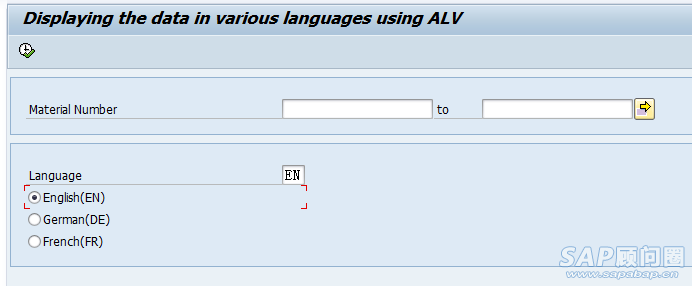

选择屏幕

  43.   t_fieldcat TYPE slis_t_fieldcat_ALV,
  44.   l_fieldcat TYPE slis_fieldcat_alv,
  45.   t_layout TYPE slis_layout_alv.
  46. *"Selection screen elements............................................
  47. SELECTION-SCREEN BEGIN OF BLOCK blck WITH FRAME.
  48. SELECT-OPTIONS:s_matnr FOR mara-matnr.
  49. SELECTION-SCREEN END OF BLOCK blck.
  50. *"Selection screen elements............................................
  51. SELECTION-SCREEN BEGIN OF BLOCK blk WITH FRAME.
  52. *"Parameters...........................................................
  53. PARAMETERS:
  54.   p_lang LIKE sy-langu.
  55. *"Parameters...........................................................
  56. PARAMETERS:
