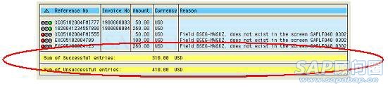

Result:
‘Sum of Successful Entries’ 行用绿色表示,
‘Sum of Unsuccessful Entries’行用红色表示。
