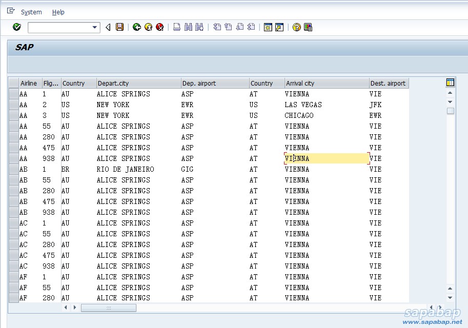

执行结果:

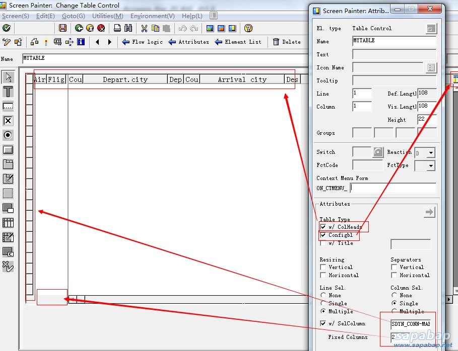

二、screen 100
1.attribute->normal
2.element list->ok_code
3.flow logic
