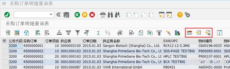

1、原先ALV报表只有一个布局按钮
  1.   CALL FUNCTION 'REUSE_ALV_GRID_DISPLAY_LVC'
  2.     EXPORTING
  3.       is_layout_lvc            = gs_layout
  4.       it_fieldcat_lvc          = gt_fieldcat[]
  5.     TABLES
  6.       t_outtab                 = gt_alv[]
  7.     EXCEPTIONS
  8.       program_error            = 1
  9.       OTHERS                   = 2.
2、要求需要三个布局按钮来调整alv展示样式
  2.     EXPORTING
  3.       i_callback_program       = sy-repid
  4.       i_callback_pf_status_set = 'PF_STATUS'
  5.       is_layout_lvc            = gs_layout
  6.       it_fieldcat_lvc          = gt_fieldcat[]
  7.     TABLES
  8.       t_outtab                 = gt_alv[]
  9.     EXCEPTIONS
  10.       program_error            = 1
  11.       OTHERS                   = 2.
  1. *---------------------------------------------------------------------*
  2. *       FORM PFSTATUS                                            *
  3. *---------------------------------------------------------------------*
  4. *Form for settings the pf status to the alv
  5. FORM pf_status USING ut_extab TYPE slis_t_extab.
  6.   SET PF-STATUS 'STANDARD_FULLSCREEN' OF PROGRAM 'SAPLKKBL'.
  7. ENDFORM.                               " PF_STATUS_SET
