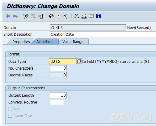

1、se11 创建一个日期类型的domain

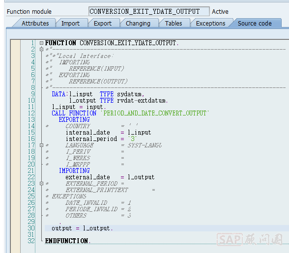

FM:CONVERSION_EXIT_YDATE_OUTPUT
source code
  1. FUNCTION CONVERSION_EXIT_YDATE_OUTPUT.
  2. *"--------------------------------------------------------------------
  3. *"*"Local Interface:
  4. *"  IMPORTING
  5. *"     REFERENCE(INPUT)
  6. *"  EXPORTING
  7. *"     REFERENCE(OUTPUT)
  8. *"--------------------------------------------------------------------
  9.   DATA:l_input  TYPE sydatum,
  10.        l_output TYPE rvdat-extdatum.
  11.   l_input = input.
  12.   CALL FUNCTION 'PERIOD_AND_DATE_CONVERT_OUTPUT'
  13.     EXPORTING
  14. *     COUNTRY         = ' '
  15.       internal_date   = l_input
  16.       internal_period = '3'
  17. *     LANGUAGE        = SYST-LANGU
  18. *     I_PERIV         =
  19. *     I_WERKS         =
  20. *     I_MRPPP         =
  21.     IMPORTING
  22.       external_date   = l_output
  23. *     EXTERNAL_PERIOD =
  24. *     EXTERNAL_PRINTTEXT       =
  25. * EXCEPTIONS
  26. *     DATE_INVALID    = 1
  27. *     PERIODE_INVALID = 2
  28. *     OTHERS          = 3
  29.     .
  30.   output = l_output.
  31. ENDFUNCTION.

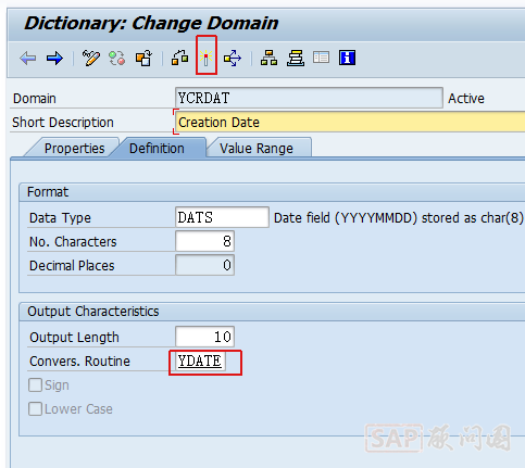

3、回到刚才建的domain,Convers. Routine输入YDATE(刚才自建函数的自定义部分);保存激活
双击‘YDATE’,弹出如下界面,可以看到domain上绑定的这两个函数

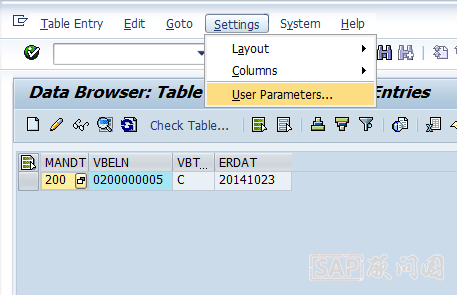

5、向YDATA_UTL表中插入一条数据
6、菜单Settings->User Parameters
7、执行查看结果
