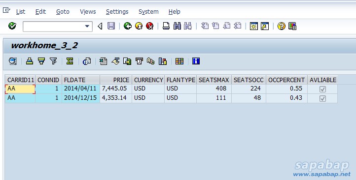

执行执行效果:

  43. DATA:L_LAYOUT TYPE LVC_S_LAYO.
  44. L_LAYOUT-CWIDTH_OPT = 'X'.
  45. DATA:LT_FIELDCAT TYPE LVC_T_FCAT.
  46. DATA:LW_FIELDCAT LIKE LINE OF LT_FIELDCAT.
  47. LW_FIELDCAT-KEY = 'X'.
  48. LW_FIELDCAT-COL_POS = '1'.
  49. LW_FIELDCAT-FIELDNAME = 'CARRID'.
  50. LW_FIELDCAT-SCRTEXT_L = 'CARRID11'.
  51. APPEND LW_FIELDCAT TO LT_FIELDCAT.
  52. LW_FIELDCAT-KEY = 'X'.
  53. LW_FIELDCAT-COL_POS = '2'.
  54. LW_FIELDCAT-FIELDNAME = 'CONNID'.
  55. LW_FIELDCAT-SCRTEXT_L = 'CONNID'.
  56. APPEND LW_FIELDCAT TO LT_FIELDCAT.
  57. LW_FIELDCAT-KEY = 'X'.
  58. LW_FIELDCAT-COL_POS = '3'.
  59. LW_FIELDCAT-FIELDNAME = 'FLDATE'.
  60. LW_FIELDCAT-SCRTEXT_L = 'FLDATE'.
  61. APPEND LW_FIELDCAT TO LT_FIELDCAT.
  62. LW_FIELDCAT-KEY = ''.
  63. LW_FIELDCAT-COL_POS = '4'.
  64. LW_FIELDCAT-FIELDNAME = 'PRICE'.
  65. LW_FIELDCAT-SCRTEXT_L = 'PRICE'.
  66. APPEND LW_FIELDCAT TO LT_FIELDCAT.
  67. LW_FIELDCAT-KEY = ''.
  68. LW_FIELDCAT-COL_POS = '5'.
  69. LW_FIELDCAT-FIELDNAME = 'CURRENCY'.
  70. LW_FIELDCAT-SCRTEXT_L = 'CURRENCY'.
  71. APPEND LW_FIELDCAT TO LT_FIELDCAT.
  72. LW_FIELDCAT-KEY = ''.
  73. LW_FIELDCAT-COL_POS = '6'.
  74. LW_FIELDCAT-FIELDNAME = 'PLANTYPE'.
  75. LW_FIELDCAT-SCRTEXT_L = 'FLANTYPE'.
  76. APPEND LW_FIELDCAT TO LT_FIELDCAT.
  77. LW_FIELDCAT-KEY = ''.
  78. LW_FIELDCAT-COL_POS = '7'.
  79. LW_FIELDCAT-FIELDNAME = 'SEATSMAX'.
  80. LW_FIELDCAT-SCRTEXT_L = 'SEATSMAX'.
  81. APPEND LW_FIELDCAT TO LT_FIELDCAT.
  82. LW_FIELDCAT-KEY = ''.
  83. LW_FIELDCAT-COL_POS = '8'.
  84. LW_FIELDCAT-FIELDNAME = 'SEATSOCC'.
  85. LW_FIELDCAT-SCRTEXT_L = 'SEATSOCC'.
  86. APPEND LW_FIELDCAT TO LT_FIELDCAT.
  87. LW_FIELDCAT-KEY = ''.
  88. LW_FIELDCAT-COL_POS = '9'.
  89. LW_FIELDCAT-FIELDNAME = 'OCCPERCENT'.
  90. LW_FIELDCAT-SCRTEXT_L = 'OCCPERCENT'.
  91. APPEND LW_FIELDCAT TO LT_FIELDCAT.
  92. IF P_CHECK = 'X'.
  93. LW_FIELDCAT-CHECKBOX = 'X'.
  94. LW_FIELDCAT-KEY = ''.
  95. LW_FIELDCAT-COL_POS = '10'.
  96. LW_FIELDCAT-FIELDNAME = 'AVLIABLE'.
  97. LW_FIELDCAT-SCRTEXT_L = 'AVLIABLE'.
  98. APPEND LW_FIELDCAT TO LT_FIELDCAT.
  99. ENDIF.
