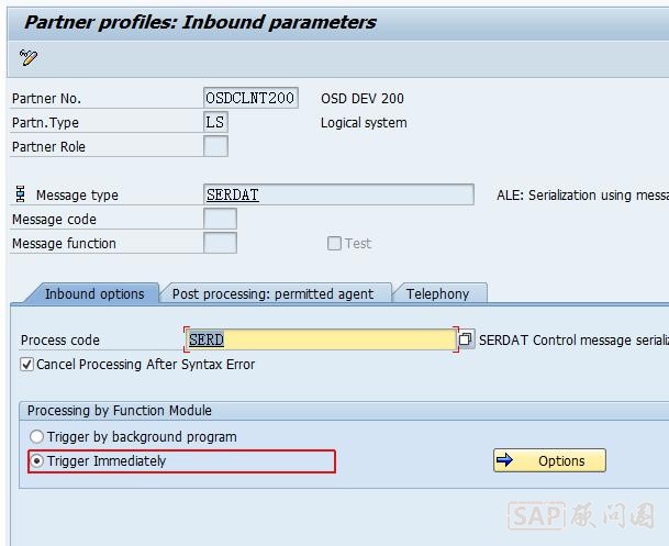

Inbound的partner profile中,Processing by Function Module中,除SERDAT外,其他Message type都需设置成Trigger by background program

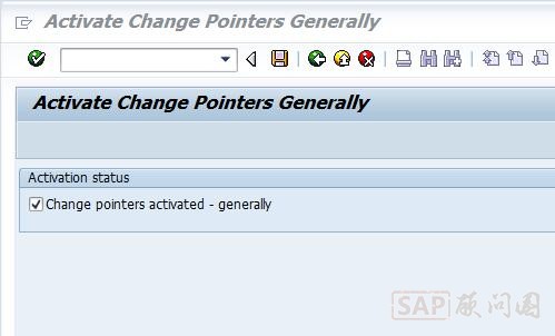

5、BD61 Enable Change pointers
发送系统client 200
BD50 all the message types

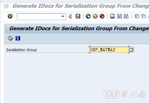

7、 相关的几个程序:RBDSER01(创建),RBDSER02(分发),RBDSER03(检查接受状态),RBDSER04(直接接收)
接收系统client 100
Creating IDocs :RBDSER01
