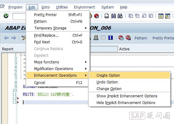

se38新建程序
Enhancement Operations -> Create Option
